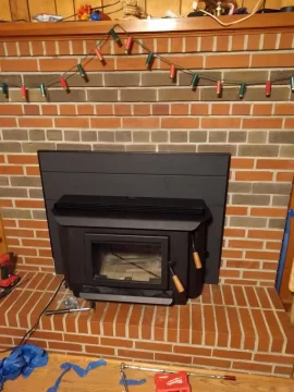

Finally got my Princess Insert completed, with an insulated stainless liner, roxul at the top and bottom of the flue, and a block-off plate above the stove. Hopefully I did everything right, I hate doing stuff twice.
I got a 5" tall rectangle bent up buy a local metal shop and bolted it to the top panel because my fireplace is taller than most. I'm having a bit of trouble sourcing longer pieces of the aluminum trim that goes around the surround, so it stops 5" short of the hearth, but I don't think it looks too terrible. I'll probably eventually get some more trim and fix that.
The "black" high-temp paint I got to repaint the surround after modifying it turned out to be closer to grey, but it doesn't look bad in person.

Nice! Congratulations, it looks fantastic.

Two tone paint looks great! looks like you did your homework did hearth.com help you along the way before you did the install? Something I neglected to do but like I said working out the bugs.

I did a lot of research here, and that's what turned me onto Blaze King. Well, that and what I think was a good price I paid for the stove. I had been thinking of getting a stove for years, and initially wanted a PE Summit insert(which I'm sure is a fine stove), but there are very few dealers around here for any brand and no real competition.
I'm currently waiting for a load of wood to be delivered, and I'll fire up the stove later this evening to cure the paint. It's a shame it's going to be 80 degrees here today, but it's going to cool back off.
