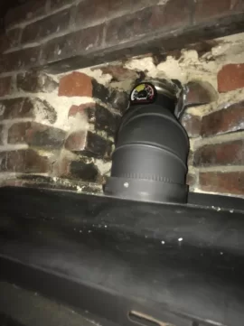

How would you guys tackle this block off plate? It’s very tight up there.
Honestly i would pack it with ceramic wool and then mortar over it with chambertech
