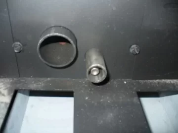

This is not a big E but these are the doors. They need to be clean every other week or so. They will not cause a clinker, they are air chambers. How big of a clinker was it?
Eric

No just alot of dust out of your exhaust pipe.
