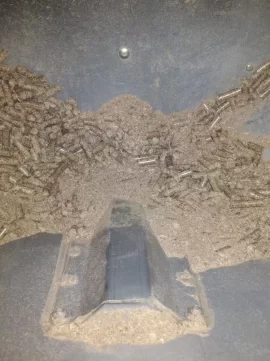

Breckwell cleaning reminder ***Pic***
kinsmanstoves
***Disclaimer*** This is not to make fun of anyone so all you "DoGooders" slow down! This is a training tool.
Please remember to allow your hopper to run dry once a month or so or this will happen. The fines over a period of years had built up and jammed the auger. No damage was done but did need the cover plate removed to clean out the problem.
Carry on!
Eric

HA HA! looks like what I was getting from NEWP last year ...but I got it after only a couple of bags!
I get that out of my stash of NEWP's right now, usually after a couple of bags. I am just vacuuming out the hopper at the end of the week, and the clean out. I also started pouring the bags into my 18inch bucket and sifting the pellets a little before scooping them, in this way the sawdust ends up in the bottom of the bucket, not the hopper.
If that is what you get after a couple bags I would be going back to the dealer and screaming. Deal or no deal that is not right.
Eric
Eric
Excelent Tip. and not just to the Breckwell owners.
