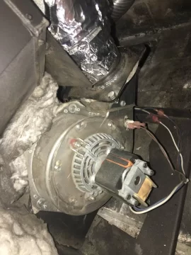

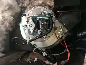

The sensor that turns on the warm air room blower. (Convection Blower) on and off is the mini ceramic snap disc located under the exhaust blower on the exhaust housing. It is the small round white disc with 2 wires clipped on it. This snap disc fails often. See pics 1-2.

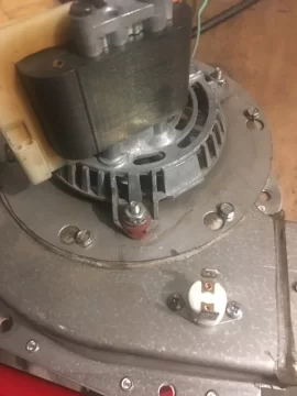

Personally I prefer to upgrade it to the regular size snap disc but that Is a big job. See last pic
