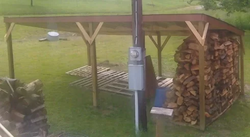

Here is the wood shed I put up last week. Took me about four full days. Made it 12x20 and hope to get better than eight cords in it.

Sorry just figuring out how to post pictures

Nice job firefighter. You'll be loving it this winter when you're not hasseling with a tarp.
I'd like to build a proper woodshed, but am concerned about getting the support posts correct. The PT 4x4 fence posts in my garden lasted less than 10 years. What is the best way to ensure longer life? Are you direct burying the pressure treated corner posts or are they in a cement footing?
Fire - I like that alot. Thats exactly what I need. Did you take out a permit to put that up?
