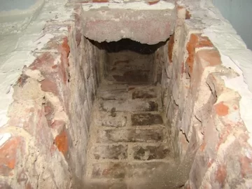

10"by10" rectangle chimney? Not making sense to me.
Cheers
The interior tube of the chimney is 10 by 10
Here is a pic of the cutaway view looking up.
all my chimneys are like this and are almost 60 ft. The draft is huge.
I had to open this one up but never ended up using it

That looks square to me.
oops, yes - wrong word
a 10x10 shaft should be called square not rectangular
thanks for correcting that term
