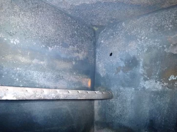

I will be building new secondary burn tubes because these are welded in and replacements are not available.
Can someone tell me why there would be this hole above the back burn tube on both sides?
Should I order 304 or 316 stainless tube, does the manufacturer of stoves have to treat the stainless in anyway or is it just plain old stainless tube.
Does it need to be seemless?
Thanks in advance.

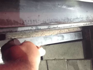

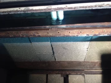

The tube appears to be in decent condition. Are there cracks not showing in the picture?

The back burn tube is ok, its the front tube and angle iron support that has a broken weld and so I thought I'd replace them both at the same time. I have an email in to ironstrike but no answer yet. Is that number for the manufacturer in Washington? The newer stoves are bolted in and mine are welded so I need to make them myself.
