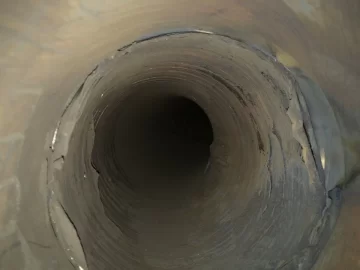

Cleaned the chimney today and was pretty bummed when I took apart the T and saw this. [Hearth.com] Bummin over my Flex King Pro
Three years old and it is peeling apart. Anyone else have this issue? I think it's time to pull this out and put something else in.

The way it's kind of 'picked' up in places do you think your cleaning method could have damaged it?
That's my best guess. The bottom of the liner has some bends to it. Cleaning from the top down the brush gets a little sticky towards the bottom. It would be nice to avoid the sticky part of the cleaning but how do you avoid this and still keep that section of your liner clean?

I wouldn't know unfortunately, and I hear what you're saying. I did have a local sweep tell me that with these new liners often you have to trim your poly brush a bit otherwise it'll damage it? Hopefully some of the experienced members will chime in.

A poly brush can do that to those liners to they are really delicate. We will not clean them anymore without the customer signing a disclaimer.

Yes it is a poly brush. I bought both the cleaning kit and the liner together from chimney liner depot. I would have to imagine both the brush and liner are paired up correctly.

When I clean top down most of liner I barely feel any resistance. If I cut the poly brush wouldn't these sections get missed during the cleaning?
Yes. Multiple flue fires can cause the liner to fail.

Sounds like a really inferior liner! I install and clean several dozen light wall liners a year and have never seen this happen. Many have been in service for 10 years or more.

I always recomend heavy wall flex liner but i honestly feel that any liner on the market is more durable than the lightwall 2ply smooth wall stuff.

Absolutly it happens all the time we see burnt creosote in chimneys often and the homeowners usually dont know. But that damage was not from a fire

This is not plain old light wall liner it is the 2ply smooth wall stuff. I have seen quite a few light wall liners fail but not like that. But most of the 2 ply ones i see have fish mouths that will eventually get snagged

I have no clue. We installed a few one failed in a year and the others we pulled and replaced out of our pocket because we didnt trust them.

You dont clean enough of them then we have a couple a month that dont clean up nicely. Usually uninsulated ones but some are insulated some are heavywall which is also smooth. No matter what the liner is people will find a way to mess them up sometimes.

Is there a warranty on the liner covering this?
Good question. I will call CLD and repot back.
The liners and chimneys we deal with all offer lifetime warranty to the original purchaser.
