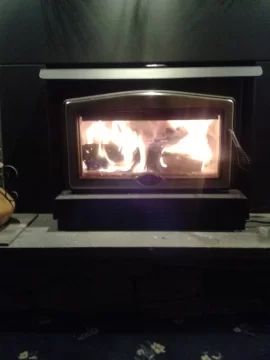

Here is a picture with the stove at 300 degrees, 3 pieces of wood on hot coals, and air rod fully shut.Link Removed
He did not suggest downsizing the liner, but when I sent photos of the insert blazing with the air pushed in, he was quite surprised. That's when he suggested putting on a smaller cap. I also told him my stove top can reach 400 degrees when it's blazing, and that I had concerns. He pretty much told me that I can throw away the temp gauge and the new steel stoves are trouble free as far as temperature goes. He told me the top could hit extreme temperature and that it would be fine!

Don't know why that's sideways!
Looks more like -90 degrees. LOL Next time, shoot the picture with the cellphone held horizontally. I'll fix this one for you.
