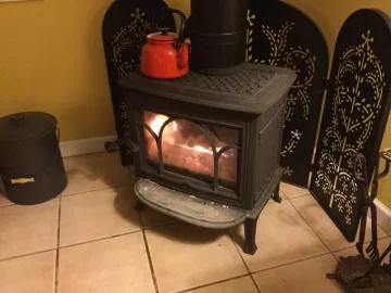

We have a tiny Jotul F100, but our house is 800sf and one story. Once the stove is a warm 350, I rake the wood and coals forward (I generally don't pack the stove initially), and pack it with wood to the back. Then the stove will quickly get to 600 and I damp it down 1/3 to 1/2 in a couple of steps. The house will get to 70 on a 20 degree night. I use whatever wood I can get. Some poplar in the warmer times, then oak, maple, locust etc in colder times. Burn times are dependent on the wood, but the best wood will last 6 hours and leave workable coals to rake forward and start again. After 6 hours, the stove is definitely below 350. If I wait overnight 8 hours, the coal bed is warm, but not enough to keep the fire going, so I have to start again from scratch. While it's the perfect size for the house, I do wish the burn time was a tad longer. It also favors "tiny" wood less than 5" diameter, so I spend a lot more time splitting and resizing the fuel.
  • [Hearth.com] Burn times, firebox size, stove temps?  How often do you reload?

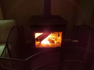

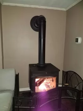

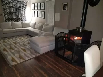

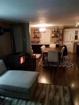

I get 6-8 hour burn times depending on what type of wood and how dry it is. I'm getting closer to 6 with the non seasoned maple I'm burning right now but I'm getting to 75 upstairs/ 80 downstairs with 30's outside.
I'm still learning the AAS setting and how much to choke it at night though. Sometimes the wood gets too choked and I get some lumps of char but no real red embers if I go 8 hours and choke it fully. I'm also only loading 3/4 with 4-5 inch splits too though.
I have 1050 ft ( about 500 per level ) and a halfway finished full height basement ( concrete floors and block walls ). I leave the basement door open and all bedrooms open. Basement gets to 60-65 ( very comfortable for my Shepherd ) and the upstairs floors stay 70-80 ish. On super cold nights ( 15-20 outside ) upstairs hits 65 though in the morning.
This forum has helped me a lot. Plenty of knowledge here and I'm thankful I found it! My coworker convinced me to get this thing ......and I bought it on a whim lol
