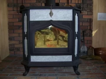

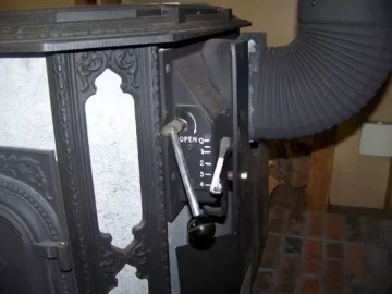

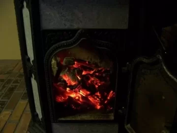

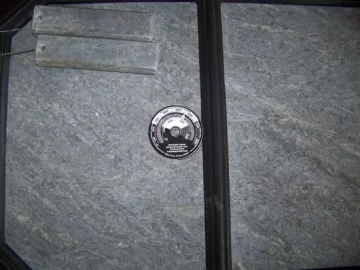

I know you guys and gals love pictures so I thought I'd post a few and discribe how I get the most heat from my stove. First couple pics are the coal bed this morning after a 10+ hour burn last night. Stove top was a tad over 200, opened bypass, raked coals forward, turned air up to #2, loaded 2 splits of Black Locust E/W, and 2 more shorties N/S.
  • [Hearth.com] Burning My Fireview

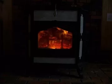

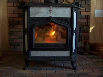

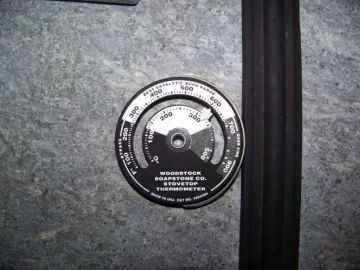

I engaged a tad over #1 after 15 minutes in bypass mode for this load and let her burn for about 45 minutes til the stove hit 600, then turned it down to about .8. Here's a pic of my painted air settings which make it easier to read in dim lighting and another pic of 5 minutes after engaging the cat.

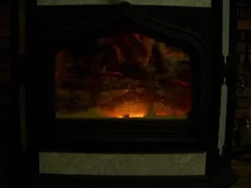

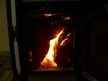

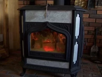

She's pumping out the heat, climbed up to about 650 after I turned it down to .8, then slowely dropped down to 550 where it's holding now. This is what my fire looks like at .8 at 600 degree stove top. The pics aren't the best and I have a hard time sizing them without getting an error message, I wish it was easier to post pics here like other sites.

Thanks for the pics. Good idea painting the heat settings. I would post a lot of photos from stoves working in our showroom under different conditions if it didnt require an act of congress to do so

Some more pictures. I'm leaving the air at .8 and that should give me a good 8 hour burn with a similar coal bed as previous picture. Then I will pack it full before I go out and celebrate New Years Eve.

Looks pretty typical Todd. Good pictures and thanks for posting them. You are right about the painting on the numbers. I may have to give that a try.
On the boot driers, we just took the chains off ours as we can see no need for them. Also, no worry about that chain scratching the surface of the stone.
I never thought about taking the chains off, DUH! I don't use them much anyways.
Thanks, Todd. It's interesting to note that it has gotten much colder I'm setting the air at .7-.8 and getting the same fire as when I was at a few days ago. The cold definitely improves your draft!
Todd - Great idea regarding the painted numbers. So simple yet so functional. Thanks.
