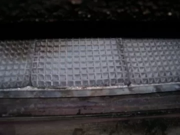

    Well if this is true, I guess I cant heat my home anymore with this stuff. :red:
    Maybe yr6 is when it plugs up?
