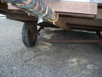

Well, my little 5 X 7 Utility Trailer came to is end today.
Was hauling a small load of maple that I cut and split at the mom in laws, and got 1/10th mile down the road and the axle snapped.
Not happy, considering it was 88 out and pretty humid. Got my garden cart out of the garage, and made the schlep down to the trailer to haul the wood back to the house. Then, backed up the trailer 1/10 mile back into the garage.
Not sure what I am going to do with it now......funny, after stacking the wood, I would be surprised if it was even 600-700 pounds or so.
Not yournormal axle that goes all the way across, but basically the wheels and leaf springs on either side, with a metal rod that goes from side to side and itsnapped.
So, talk about a waste of a day...cut a bunch of logs, split a bunch of rounds....only to put in in the trailer, than take out of the trailer 1/10 mile awat....not a good day...I need a beer....maybe more.
Gotta get that freakin truck now.

^yeah I was thinking just weld it up ...it's an off road trailer still has a lot of life to it.

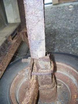

Well, I guess its not an axle per se. Basically, it is a metal bar that goes from the left to right wheels, and it snapped about 10 inches from the left wheel. (It is the main structural piece that went from the right wheel to left, but did not actually connect to the wheel) when it snapped, both wheels caved outward along with the springs. Since the trailer frame is pretty old, and now some of the major pieces have been bent as well, I don't think its worth the $$ to fix....only paid $300 for it last year....its pretty old. If you look at where it snapped from one of the ends, the metal is in the shape of a T.

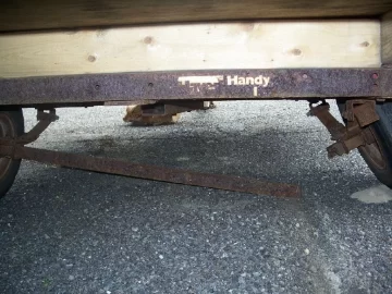

After tipping the thing upside down, and seeing all the rust, I don;t thin its worthy of a repair....most of the metal is bent, and had I seen the underside of it, I would probably have not used it.
Looks like its truck or a new trailer for me.

Probably tough to weld rust eh ?

Yep, I'd say you're ready for an upgrade. Looks like you got your moneys worth out of it.
Just get some square tubing that has an ID of that axle, get larger U-bolts, and redneck it back together. %-P
rust is no problem if there is some sort of base underneath it. 6011 rod is a farmers friend, aggressive penetration and fast freeze.
I'd hoist it upside down, weld on on some angles, use it a garden/home cart and get a better trailer for the highway.
Looks like it's mostly the axle that is gone, might (or might not) be worth looking into just getting a new axle and possibly springs.... Of course this assumes that all the duct tape on the tongue is just holding the wiring harness on, not keeping the trailer together... ;-P

Good one Goose and Lee....all that tape gave me an extra 50lbs on the tongue :) just kidding.
Yeah, the wood part of the trailer is fine, but all the metal underneath is beyond its life....springs are bent, and the wheels and bearings are a little scary....going to scrap the metal stuff and keep the wood part
I'm looking at some of base 4 X 8 trailers on tractor supply/harbor frieght, and I am just going to take the wood frame off and apply to the new trailer.
