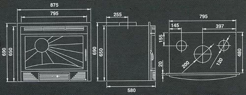

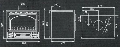

Also my husband was checking the dimensions of the 12KW model and he is now thinking that it is too small. It certainly is small when compared to the 16KW Madrid. And personally we like the aesthetic look of the 16KW model more since it's somewhat more modern looking.

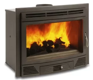

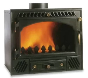

Here are the 12KW Astorga and its dimensions, and the 16KW Madrid and the dimensions. I'd appreciate your advice on this.

I was going to suggest the Madrid but didn't think you would go for the more modern look. I wouldn't worry too much about the regulation. If you want less heat upstairs, close the registers down a bit.
I was acually afraid that the Madrid would be giving me less heat upstairs, since I can't close up its frontal blower!
Now if that isn't the case, it's another story!
If the duct runs are kept clean with a minimum number of elbows, then the ducted heat should be good. What did you decide? Interior ducts or exterior insulated ducts? If exterior, how do they propose to insulate them? Do they have a demo unit that you can feel the output difference between the frontal and ducted output? If not, can they lend you a manual to see what Bronpi recommends for balancing the output?

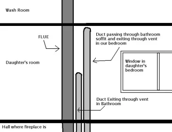

So far we decided on interior un-insulated ducts. Two of them. One opening into the bathroom upstairs and the other one passing above the soffit (false roof) of the bathroom and exiting into our bedroom.
Our issue now is chosing the best stove to give us the best heat in the upstairs rooms where we really want to be comfortable, and the maximum it can downstairs to minimise the chill factor between one part of the house and the other.
Here's a picture of how flue and ducts are supposed to go up.
Obviously everything will then be enclosed.
The diagram shows a cross-section, with the main part showing the works in daughter's bedroom, all connections come up from the hall downstairs and the flue alone goes up through the washroom and out through the roof.
(Edit: the ducts might be inverted, ie the longer one being near the flue)

Looks like a setup that should work, the only question being if it will produce enough heat in total...
