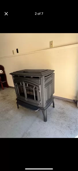

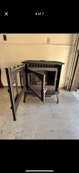

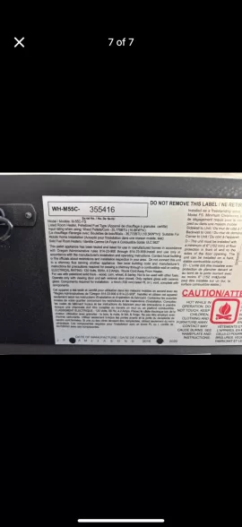

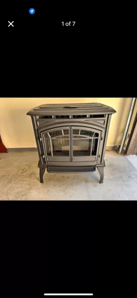

Ok this seems like a great deal to me but want to check with the pros here!
Enviro MC55 freestanding pellet stove listed for $1500, they’re willing to do $1300.
They said it works great and I will test it before purchasing.
Good deal or would you pass?

If the stove is clean and everything works as
Intended, the piece is very good
A new one in Canada costs over 5 thousand
As a person who likes Enviro, I would buy it
Here it would be priced used at around 25
hundred or more
She looks to be in good condition. Hopefully you can start it up, that is the true test. The price is very good, it being only 6 years old. Stay warm.
Yes, we plugged it in and she started right up!
They never even used it- it's been sitting in their garage since they purchased it brand new! They bought it to replace their wood burning stove but decided not to install it after they realized how much free wood they have access to on their property. We brought it home yesterday- cannot wait to install it! It is so beautiful!
