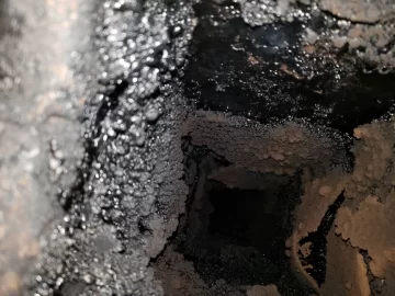

Thanks a lot for the replies. Tried to take a picture up the chimney. But yes I'll give it a good cleaning.

If you dont, you really shouldnt be using it, That is chimney fire waiting to happen.
Eeek!
You may need chemical assistance with that shiny stuff.
creosote removing powder or a csl log. you can get both at most hardware stores. from the picture you put up you need to get drier wood or run the stove a little hotter or both.
