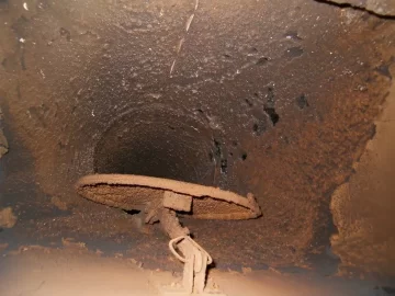

My first attempt at posting pictures........
[Hearth.com] Calling on Blaze King Princess Insert Owners [Hearth.com] Calling on Blaze King Princess Insert Owners [Hearth.com] Calling on Blaze King Princess Insert Owners [Hearth.com] Calling on Blaze King Princess Insert Owners [Hearth.com] Calling on Blaze King Princess Insert Owners [Hearth.com] Calling on Blaze King Princess Insert Owners [Hearth.com] Calling on Blaze King Princess Insert Owners [Hearth.com] Calling on Blaze King Princess Insert Owners [Hearth.com] Calling on Blaze King Princess Insert Owners
I know my chimney needs cleaned! The last pic is the back of the insert. It has insulation to put on the sides, but moving it around, they don't stay. The damper that you see on the top, obviously doesn't hook to anything, and is pretty much centered in the flue exit. This is another reason it appears to me that this wood burning insert was meant for this fireplace.(?)
View attachment 215068 View attachment 215069 View attachment 215070 View attachment 215071 View attachment 215072 View attachment 215073 View attachment 215074 View attachment 215075 View attachment 215076
