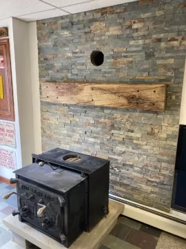

They say the Ashford 30 needs to be 6" from the back wall with a double wall pipe.I am just going to make that I think.I am not sure how far the pipe has to be from any other obstacles. I have an old beam that I got from the farmer down the road and mounted it.Here are a few pictures.The pipe should be more then the 6" from the beam.
I am dropping that 3'x3' stone to the floor also. The stone is 2" from the back wall now. So I have 38" to play with. Acually I would want the stove to sit back 3" from the front edge of the slab of stone so I have 35" total.I am hoping it works out. Do you see any issue here?
I have had that timberline for 25 years. It has to be 35+ years old.It did work well. Time to upgrade!

The old Timberline was an insert adapted. The new stove should make the insurance company happier.
It looks like you have room. The 6" rear clearance is the minimum. There is no harm in exceeding it. This clearance is measured to the nearest combustible, which in this case appears to be the studs behind the stone veneer wall, if that is applied on cementboard.
The stovepipe clearance depends on whether it is single-wall (18" clear) or double-wall (6" clear). Blaze King recommends double-wall stovepipe to connect their stoves.
What is the stove venting into? Is this a clay tile-lined chimney or is there a stainless liner in it? If tile-lined, what size? Internal or external wall chimney?

Min clearance is to combustible surfaces. I have one of my Ashfords (the one photo'd above) less than 6" from rear wall. BKVP had told me that putting it very close to the wall could mess with the thermostat behavior, but we agreed that 4" would be a reasonable compromise, given my wall is very definitely non-combustible (stone house).
Yes I will go with the 6" double wall. I believe my clay tile-lined chimney is 8"x 8" and it is an external wall chimney.
