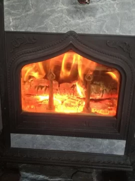

    Well I believe the brush and duster can worked excellent now I need to get on the horn with Woodstock about a replacement baffle as mine is warped from previous owners stove is working excellent though ImageUploadedByTapatalk1359682468.725159.jpg
