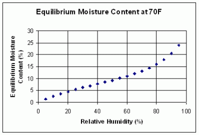

According to a study [1] done by the USDA, the equilibrium moisture content of your beautifully dried stacks in Michigan will vary from 12.3 to 15.1 percent, throughout the year. Because your wood is a sponge. This follows the relative humidity for your climate, plotted here at 70F. Relative humidity goes up, and your equilibrium moisture content goes up, but you'll not see your stacks grow unless they're already at MC below 15%.

According to your USDA study, you say my stacks should vary from 12.3 to 15.1 percent. That is interesting because of the statement that the wood will sort of match the relative humidity. I can assure you that I have never witnessed a 12-15% relative humidity in this area. However, maybe I've never left the wood long enough to dry? But certainly not to that low of a humidity.
