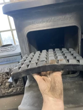

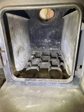

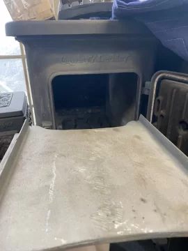

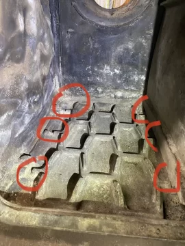

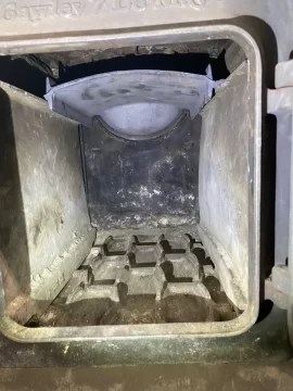

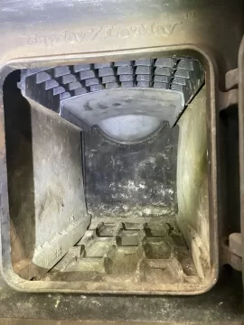

Hey Feather, welcome to the forum! And thank you, I do have a pretty bad addiction to cast iron ha. But here are some pics to help you!
First is clean out the firebox well so you can see these tabs I circled.
These stoves had reversable side plates so you could have 2 different size set ups,I find the bigger one is more stable, so thats what I have it set for. Let me know if you need anymore help![Hearth.com] Cawley LeMay(s)[Hearth.com] Cawley LeMay(s)[Hearth.com] Cawley LeMay(s)[Hearth.com] Cawley LeMay(s)[Hearth.com] Cawley LeMay(s)[Hearth.com] Cawley LeMay(s)
These stoves had reversable side plates so you could have 2 different size set ups,I find the bigger one is more stable, so thats what I have it set for. Let me know if you need anymore help!View attachment 278421View attachment 278422View attachment 278423View attachment 278424View attachment 278425View attachment 278426

No problem, happy to help . And no the top plate does not need to come off, I was just trying to show you the orentation when you get them in, just fit em through the door
