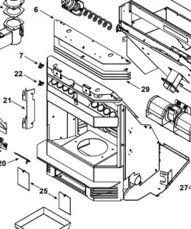

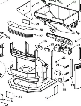

Glad you posted that. I read about that in the service manual. Problem is I can't locate it on the insert model. Unless I am staring at it and just don't see it. From the pic it looks like the right side of the stove as you face it at the bottom side of the stove. No such plate on mine.
Below are side by side from parts manual part 17 on the CB 1200 is what you are referring too I thinks. Part 25 is what I use to access the ash. Neither gets me no where near the snap discs are. Had to use a refrigerator cleaner to get near it. It worked!!!

The leaf blower trick may help do a better job getting ash out of them hard to reach areas. Yes the plates are diff due to the insert model. May even need to be taken outside for a teardown and high pressure air blow out.
You are right. Have done the outside thing many years (about every year since 2008). This time required a scrub (I do mean scrub) at a specific location near the snap discs to resolve the issue. The leaf blower I have done many times. None of these will remove the caked on ash near the snap discs location on the c1200i. I never thought the a thin layer of ash would make that difference, But it did. I only hope that someone in the future will see this and try the cleaning first before all the other replacements. Again thanks for your help. You are what makes this forums great!
