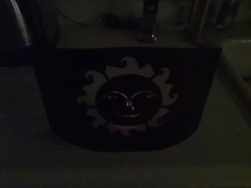

Pelletdude, here's a pict on my kitchen counter, it is very dark, did not want to wake the kids.....
Hotz, I can't see a thing in that pic.
(your kids sleep in the kitchen???) :lol:
Ah come on, you can see something! I'm not giving away trade secrets! And yes, I have twin 8 yr old boys, they don't venture far from the refrig.....

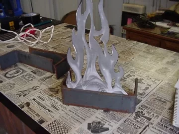

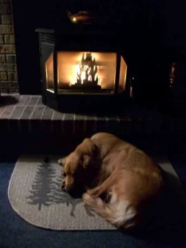

I made something similar for my new Englander insert........I have access to scrap stainless & a plasma cutter at work........Made this out of 2 L shaped pieces of strap iron & a !2" x 9" piece of stainless .....A flame insert for my stove & got rid of the ugly fake logs it came with. I'm no artist, but I think it turned out OK.
My stove flames now even with it off.
Tom in Oh

Tom, you stole my dog too!

Actually we have a matched set of pups, (brother & sister) but the female always gets to the hearth pad first ! They'll be a year old in December.
I took the fake logs out of my stove because the ash would pile up between them & the glass & look horrible. Ran it that way for a couple days, but then an occasional pellet would miss the burn pot & bounce out & lay next to the glass, smolder & stain the glass really badly, to the point I was not sure it would clean off. I had a bin of these L shaped brackets at work surplus from a job & took a couple home & placed them between the burn pot & the door where the logs would sit.
This worked to keep the pellets away from the glass, but wasn't very pretty. I had an old flame decal for a car window, & traced the outline on a piece of scrap stainless at work & cut the flames out freehand.

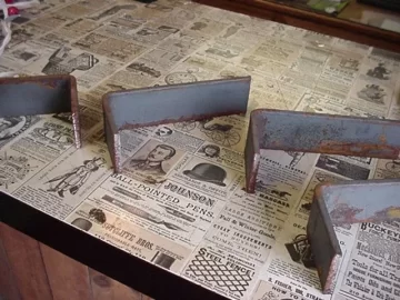

Here's a pic of the brackets I had:

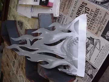

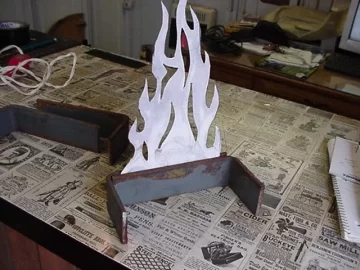

I just doubled them up to cup the front of the burn pot & laid them in to see if they would work to stop the errant pellets from getting to the glass. that worked, but was ugly. So I added the flame design. See the paper template & then see how I sandwiched it between the steel L brackets. A little welding & it was done. Hardest part was cutting out the paper template.......that took the longest.

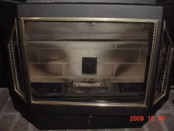

More pics: Stove without logs..........pretty bare !
