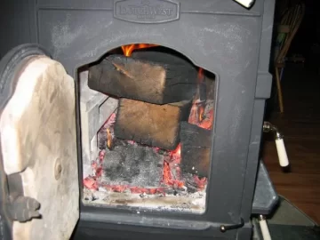

Here's a picture of my loaded stove, and one of the setup - if anyone sees anything wrong with this, let me know. This is typical, so if there is a problem, it could be part of what is going wrong. This load would work flawlessly with my dutchwest catalytic...

Another with flash- sort of makes it look like there's no flame...this particular load did quite well. I had a good stove temp (500), good flue temp (500 surface), and the secondary worked well after a little adjustment of the load a couple of times. I intentially crammed a lot of wood in there to see if my seal made a difference. I tried to avoid making my "tunnel" from front to back to the throat of the everburn. It drives me crazy if I have to be extra careful in making sure there's a clear path at the bottom of the load from front to back.

Nice installation Mike. First time I've seen one from a cat's eye point of view. Did you do the tile/stone work yourself? It looks especially nice. What types of stone did you use? Do you have a human eye view of the same?
I don't have a picture that's small enough to meet the size limit. It's all tile - it's the green "Rialto" that you get a Lowes - heavy porcelain that has been smacked with a hammer. It was done just before I bought the house. I would have left the tiles whole, but it works. I eneded up replacing the entire chimney/support package/flashing right after I moved in. It was a 6" flue with adapter going into 8", which I did not like. The lady also used the cheap pre-fab stuff that you get at lowes. I replaced it with Metalbestos SS. It's amazing that a 3' section of the 6" SS pipe weighs more than the 3' section of the 8" lowes-bought pipe. I think the stuff at lowes is a lower-end selkirk product. I don't know why they don't just sell the good stuff everywhere instead of having a cheaper version for wal-mart and lowes? Duh...
