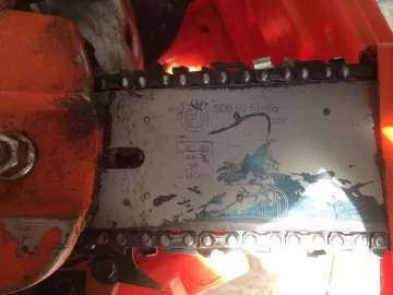

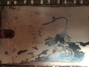

Sorry guys it has been a tough week but finally got out to snap a picture of the bar and chain info. What do you think? Would the stock file guide from husqvarna work?
There should be a bunch of information stamped into the back end of the bar that will indicate the size chain it uses. You may have to take the bar off of the saw to see it all. Post the numbers you see there, or just a good pic, and we can decode it for you.
Careful, there's no such thing as "the stock file guide." There are different sorts of chain, and there are different guides to match.
That is 0.325"-pitch "pixel" or narrow-kerf bar. Assuming the chain is correctly matched to the bar, this should be the right guide.
.325 pitch, .050 gauge, 66 drive links (DL), narrow kerf (NK) bar

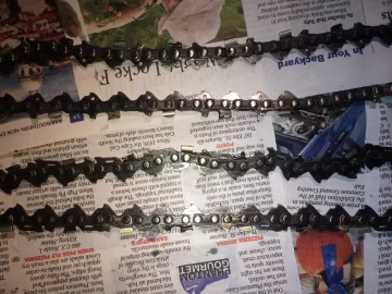

Ok I've taken the chains off and examined both. I also found the box that I believe is the second chain I bought.
Both chains

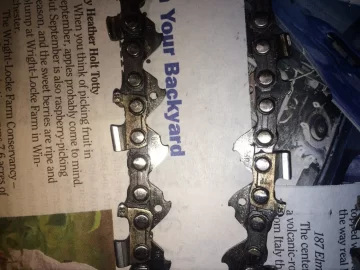

Top chain. Engraved with 30 and 25[Hearth.com] Chain Sharpening

The top chain has a 30 and 25 engraved on it. I assume this 30 relates to the box (H30)?
The bottom chain only has a number 37 engraved on it. Maybe that is the H37 that is listed on the back of the H30 box?
The ultimate goal is to get a file kit that will fit these chains. Would the kit mentioned above (505698190) work? Or do these two chains need two different files kits?
