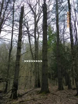

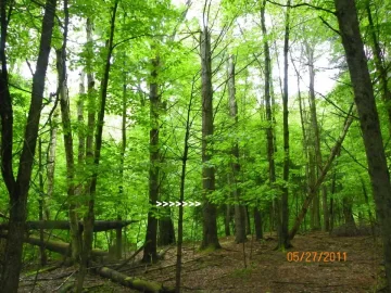

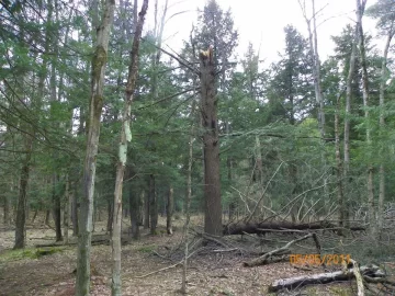

Smokin attached are three pictures of some white pine for milling, the first two pictures are the same tree at different times. The tree is 70 inches in circumference at 4.5 feet which should make the diameter 22.28 and looks to be about 24-30 feet tall.
Picture 2900 I'm not even sure the location.

What is your first prodject you want to do?

Looking for some one inch boards for a shed or cabin.
