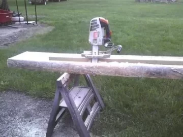

You can clearly see the hose and zip tie...This keeps you from drilling or clogging!

I wont drill any holes in my bars,not even older ones.Zip ties is a great idea.
I almost drilled and came to my senses thats alot of money and reviews say they clogs up anyway..... :cheese: That oil finds it way to the chain it has nowhere else to go.
Any bottle and tube with an adjuster and couple zip ties and your done.

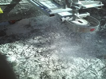

I just cut my own, my little 192t does a good job and loses very little kerf. Bet a 310 with an .043 set-up would kick @ass! Even a .325 would work as well....
I'm almost sure it's the .325.
