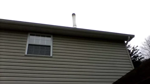

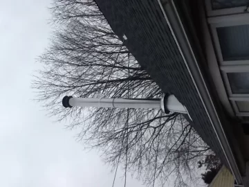

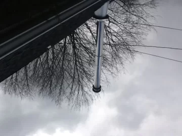

I don't know if you can see this, but here it is. The install is only about six weeks old.

Of course, I thought I had it rotated the correct way.

smartphone pic ?
my sister sends me pics taken with her iphone and I either have to view them sideways like she sends them or they go upside down, on an iPad.
Wonderful technology. /sarc

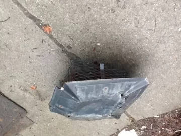

I looked aout the front door and my man furnace chimney is sitting on the ground. It blew off last night or early this morning in the wind. The cap on the chimney for the stove got cleaned by the rain and driving wind. The center ring on the cap is now shiny again. Don't know if you can see it in the pic or not.
It has dropped 10 degrees in three hours here. Still a 20 mph wind with higher gusts. Going to be a great night for burning.
