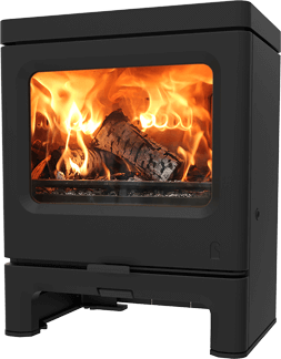

It's pricey, but attractive and functional in a way that few stoves can match.

I saw secondaries burning around 9:57 and even better at 10:50. The air for them comes from the holes at the top third of the back. Unfortunately, for most of the video he is burning a pretty low fire. As for specs and testing, I think that's on their website. Charnwood has been making stoves for about 50 yrs. They have a good rep. European testing is different, but they list the tested efficiency at 89%.
The big selling point is that as long as it is fed good dry firewood, it takes care of the rest and does it cleanly. There's no tending the fire, or riding the air control, or waiting to close the bypass damper. That is a boon to new burners. My main concern is how robust is this technology and how well will it stand up over time?

I'm going over the manual now. In the event of an outage, the stove continues at the current setting. The electronics run on 9v which an external source can supply for continued electronic control. There is a "power cut mode" that the stove can be put in for manual operation, which like you note, will not be as efficient.
One thing I notice is that it has input for a room temp thermocouple. This permits the user to set the desired room temp in the app and let the stove figure out how to maintain it.
