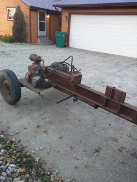

It all started from an old homemade splitter I bought at an auction for $115. It had an old 1950s B&S motor and what looks like a really old hydraulic cylinder and pump.

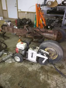

I bought a little beaver hydraulic power unit for $40 off of CL. The unit runs and pumps fluid.

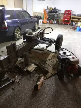

First test went well. It split wood. It didn't like some wood due to the single stage weakish pump. I need to make 2 big improvements bigger/2 stage pump and an auto return valve. I'm going to try to use the old pump that was previously mounted to the splitter. It is unknown make/model. Not sure if I'm going to disassemble the power unit and mount it all on the splitter or not yet.
[Hearth.com] Cheap Splitter Build
Functional splitter for $155 invested.

Cheap splitters are fun to build (see in my sig line). What are the specs on the hydro pump unit (HP, GPM)? Most of those portapowers were pretty low volume. I see some very promising parts available. Toss in a hunnert and change for a properly sized two stage pump and I would bet you have a decent splitter.
For ease of maneuverability I would consider integrating the parts for a single piece of equipment. Unless you have other uses for the mobile power pack, it would seem to make sense.

Yea, I've been having alot of fun with it. I have the pump that came on the splitter that I think I'm going to try. The power unit is 11hp Honda motor with what I think is a 6gpm 2700psi single stage pump. It definitely split wood but had some issues with knottier pieces.
Oh...that is just screaming for a 16 GPM two stage pump (technically you could go to a 22 GPM pump, but those pumps are at a bit more premium price).
