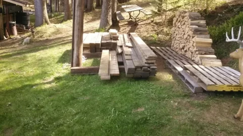

This was an old deck we removed from someones house. they are all over Craigslist....
[Hearth.com] Cheaper Wood Shed Than This?
This was after 3 days worth of work a new 24 x 6 wood shed. had to buy $150 worth of materials
$135 for 8 sheets of galv. alum steel cut to 8' so i have $300 invested totally. if you want to put the effort into re-purposing someones deck off of craigslist. i think it was worth it....

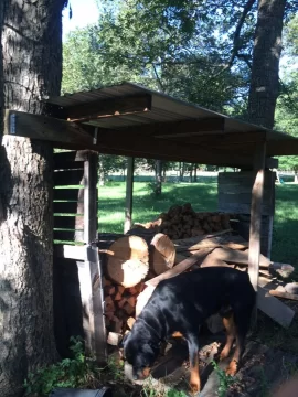

Decent looking? I don't know about that but this is the cheapest way I've found. Two big trees provide the lateral support and vertical support for the first section, then you can add to the structure laterally, the trees will then continue to provide the lateral support so you don't need big posts in the ground.
This is a picture of my sons, it's very small but shows how you start to build.[Hearth.com] Cheaper Wood Shed Than This?

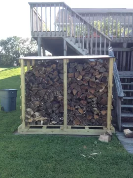

I went with fence posts instead of 4x4 posts. They were less then half the cost of 4x4 posts. Also went with 1x5 for the side slats and ripped them into 2.5" wide lengths on the tablesaw. Used a 2x4 up the side to attach the 1 x2.5" slats to. Used asphlat shingles for the roof. Probably cost me $200. So far, so good. If it snows more than a foot, I will be out there shoveling it off. Going to build 2, maybe 3, more to put under the deck close to the basement door so I don't have to worry about snow accumulation on them.
  • [Hearth.com] Cheaper Wood Shed Than This?
