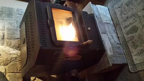

That's what I want to figure out?? I'm on 1 heat 4 blower...is there a 0 heat?...I'm confused...that's why I want to know what that "cherry pit unplug -go to 6" stuff is about cuz once running I'm on 1 heat 4 fan, & never stops to heat the box more...have run as much 1-6 and it's still radiating heat off top...NO PILE UP Link Removedas of now...been running for 3 hours. ..manually mixed by holding AOT in once...BUT STIRRER setting back to 0 otherwise
  • [Hearth.com] Cherry pits pilled in pot, Englander Multi,works better with stirrer?  Fabricate one w/smaller arms?
