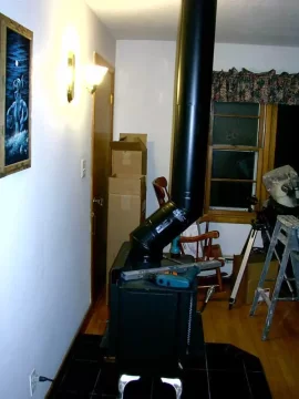

The house I had when I lived in the cities had the two 45* off sets. The chimney was only about 14', I had no problem sweeping with the brush and rods from the top down. There is a little resistance when you hit the off sets put nothing major.
My stove pipe looks like this:
I sweep from the top down, the brush goes through 45's without too much problem.
My rods are 5/16 dia, I think I got them from HD.
Use poly for stainless.

Thanks guys, The pic above looks like the same amount of offset I have. I guess I'll go with the standard 3/8's rod and see how it makes the bend. Anybody tried the 1/4 rod? Is it like pushing a rope? ;)
