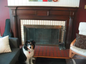

Fireplace. Opening is about 44"W x 28"H. I do think the Regency I2400 may look a little small here, but will prob blend in nicely, no? I also think it would heat the room (and probably more) just fine.

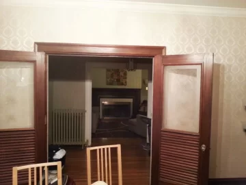

As seen from dining room (to give an idea of how the room opens to other areas):

It will heat a lot more than that room if you move some around! It's a good deal!
There are probably going to be some clearance to combustibles issues with that wood around the fireplace and the mantle. You need to explore that with the installers.
Put the largest insert you can in that fireplace with a full liner to top, and a block off plate at the damper are and you are good to go. Do check the wood parts as they may have to be removed. If you have or can install a ceiling fan in that room, that would help move the heat around also.
Reactions: webby3650
Yes, I think that wood is too close on the sides and above, floor looks good.....
If you are thinking about converting to woodheat put a bigger insert in. For 2600 sqft you will need something with a 3 cu ft firebox like the Regency I3100. Do they offer any other brand? There are a lot more companies that make nice inserts. Since you will use it and look at it for the entire time you will be living there I would suggest take your time and check out all the options.
What is the depth of the fireplace? The width and height look good, only the depth is a bit hard to judge from that picture. You will also need way more wood then; my guess would be about 4 cords per winter if you will have the stove running most of the time. Welcome to the club! :)

It looks like Clearance to the mantle is ok, as long as that mantle facing is 34 3/4". It appears to be.

In peak season, when the shop is booked a month out, $5200 will be normal business. The installer is giving good advice and a good price. It's up to the OP to decide if they want to accept it or upgrade to something like the Hampton 300i. Clearances are going to be critical with the fancy mantel.
mmjr, I don't think you will have an issue with overheating the room, that was why I asked about the area being heated. You have a beautiful house and a good insert is really going to be appreciated come winter. And you have a nice looking dog too!

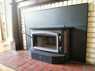

Just a quick update for anyone who followed this thread a few months ago. We went ahead with the Regency I2400 insert (we also looked at the next size up - the I3100, but there wasn't enough clearance with parts of our mantel, and we didn't want to alter that.)
Here's a pic (bit dusty -- we had it installed a few weeks ago):
[Hearth.com] Chimney can't be lined for our fireplace?
Very excited to start burning and see how much we can offset our oil costs this winter.
Thanks again for all the feedback.
Sweet, it won't be long now. How is the wood supply looking?
Very nice looking! You are going to LOVE heating with wood. The entire process of providing for yourself can be very rewarding.... Especially when you can sit in front of it and watch and feel the return of all your hard work and planning.
