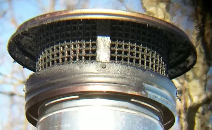

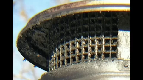

chimney cap screen getting plugged. w/pics

Pics first. Here is the cap. Pic taken with cell phone through binoculars.

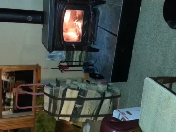

Here are the particulars of our setup...
The stove is a Hearthstone Phoenix. We installed it with all insulated pipe. I'm burning ash primarily. Wood was standing dead for years, CSS and burn in the last month. No major drying time, wood burns great no hissing or sweating. Moisture readings less than 20%.. most around 10% or less. Most wood is stacked in house 24hrs before burn. I'm getting very little ash at cleanouts. In the last 2 weeks one small 2 gallon bucket or less. This is our primary heat source so we burn 24/7. Late last winter or early spring I couldnt build a fire. A little investigating and a pair of binoculars and I could see the chimney cap was plugged. We blamed it on light burns we were doing heating in the 50 degree days. When we cleaned the chimney cap then we brushed the pipe and got about a cup of dust very little creosote. We started this season with a clean cap and pipe. I'm being told to remove the screen from the cap. Is that good advice? Also why am I getting so little ash? Thanks for your help. PB

Stove temps on the stone run up to 500. The insulated stovepipe generally runs between 250 and 450. We usually reload the stove when the stovepipe reaches 200 degrees. Air open and close as needed. [Hearth.com] chimney cap screen getting plugged. w/pics

Insulated pipe brings all the heat and moisture to the top of the pipe which is good. The problem is as it hits the cold screen all that moisture tries on condense capturing the particulate with it. This clogs the screen fairly quickly. A half inch wire mesh seems to work best as a top screen... The wire warms quickly and does not give much surface for the water to condense on...

Not the worst I ever seen, but I can almost guarantee you that wood ain't no where near dry enough.
Standing dead or not, just cut and split a month ago is damn near the equivalent of burning green wood.
If it is all you have, burn away, but keep an eye on the screen and clean as needed.
You can try bringing some wood in, if you want. It will dry fairly well in about a week or so, maybe not optimal, but much better then the state it is in right now.
A screen with larger openings ain't a bad thing either.

From the pics it looks like the screen has a pretty small mesh size and a thick wire.
I have a Simson cap ( now Dura Tec), it has a about 1/2" mesh with a fine stainless steel wire.

It might be worth replacing your existing screen with a Dura Tec screen, ( you can buy just the screen).
BTW I just cleaned my chimney yesterday and there was no buildup on the screen at all.:cool:
Yea I would install a new screen or cap with larger openings. Subjectively that screen seems restrictive. On another note though that is some pretty good buildup...and would be suspect of your wood being a primary concern.
