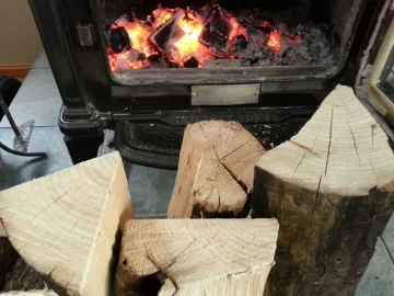

this pic of splits is typical of what we've been burning. Although occasionally a split not so checked gets in the stove of course. we have burned nothing but wood. no paper junk or cardboard. restarts are generally off hot coals.
I'm thinking the unseasoned wood and high and low stove temps are what's caused the plugged screen. My thought is to keep a better burn going and I'll have better stovepipe temps and maybe less condensation at the screen.

Checked, while an indicator of wood drying, does not always mean the wood is as dry as it makes one think. From the end cuts from what I see, they look like they were fairly recently cut.
Burn hot, and load with a slightly hotter coal bed and temp than usual, this may help. The moisture from the wood is going to go up and out either way. Taking the above steps may help reduce some.

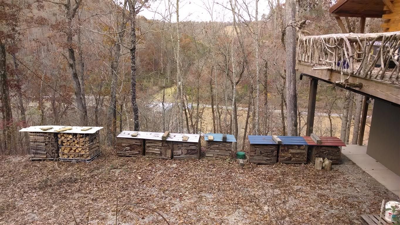

It's going to take a year or two, but I now have the time and equipment to get way ahead on wood and got a head start this season. A 8x50' open wood shed is also going up next to the basement, so I am curious to see how cleaning routines change as wood gets drier.

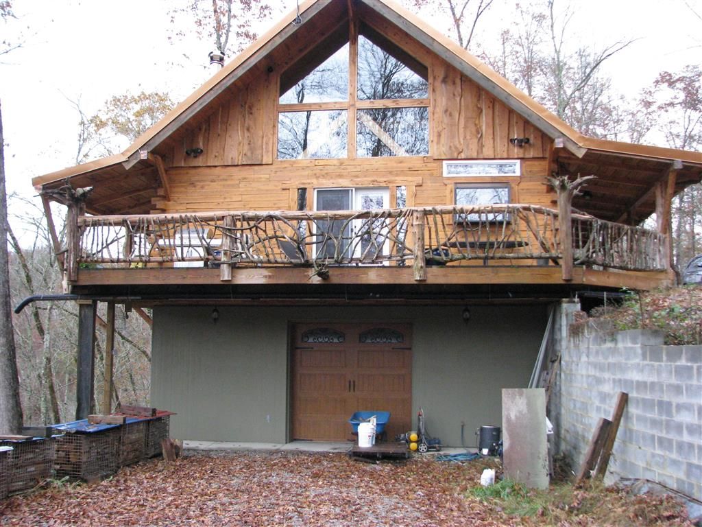

More pics of the house please!
Hog, below is a teaser pic, but if you have oh say a lot of spare time(case of beer or several pot's of strong coffee...or both...beer first, then coffee), this is the entire build thread with pictures...110 pages:

I always tell folks there were three of us building it,- me, myself and I....lot's of reality show type of in-house fighting;)

Thanks for the build comments, I still look around me at times and can't believe I got it all done and retained all my body parts in reasonable & still useable shape.

Motor7 - did pic of your place show up here before? The railing is very cool. Awesome place.

Yes, I think I posted it a while back down in the cellar where the neanderthal smoke dragon slayers meet on a full moon...our sentry will challenge you, the password is "shrubbery" , wear dark clothing, speak to no one on your journey: Classic Wood Stove Forums (prior to approx. 1993)
