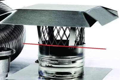

2) I am going to go with the liner from fireside chimney supply, they seem to have great customer service, products and price (see link below). My chimney currently has two flues, one for the fireplace which i will be using for the liner, and one for the oil furnace. As you can see in the picture it already has a nice cap that covers both. If i use the chimney cap that comes with the liner, can i just cut the top part (cap part) off the piece that comes with the kit and let the liner stick up, but under the cap that is already on the chiminey? I can draw this out if you don't follow. This would be the easiest and cleanest solution i can come up with to keep the furnace part covered.

I am planning on cutting the part provided shown in the picture where the red line is. If this will not work, what would you suggest?

I dont think you would have to cut anything just don't use the cap. But i dont think there will be enough space between the top of that top collar and the under side of your existing cap it looks like your cap is a 10" high cap the clay sticks up 1.5" to 2" then your top plate is 5" to 6" that only leaves a couple inches of space there. That will most likely cause a problem. i would say you either need a taller multiflue cap or use the provided one.
You need 4" from the top of the liner to the cap. It looks like you will be really pushing that. It will be best if you use the cap that's provided.

Yes and 4 is a minimum For a wood stove i like to give a distance equal to the diameter of the line. So 6" in your case. But yes 4 is the minimum
Would you try to cut a hole in the cap that i have that will go around the cap that will come with the kit? Or should i also get a cap for the furnace flue and take off the chiminy cap that is currently up there?
If there is not enough room under the existing cap you will either need to get a taller multi flue cap or use the provided one and get another for the furnace. No i would not cut a hole in the cap that is there i see gas guys do that all the time and it looks rediculous
