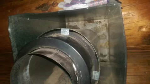

I saved up some money for a liner and got around to disassembling the cathedral box going through the wall. Had drill out the rivets so I could remove the end of the box and then I could see what I was dealing with:
[Hearth.com] Chimney Liner needed with new BK Sirocco?

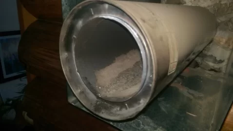

had to break out some mortar and rock to remove the class A pipe

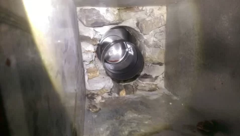

Unusable once I was finished.

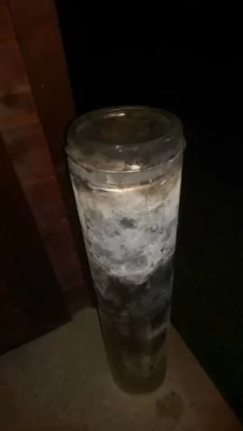

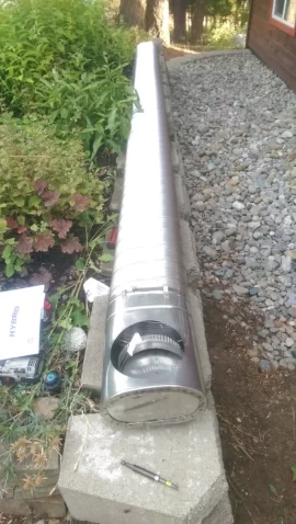

New liner kit from Rockford with a short body Tee kit

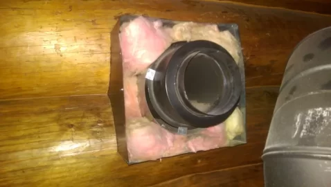

Liner installed!
All buttoned back up with a new piece of class A connected to the snout, or take off for you professionals out there, and minus all that insulation. Had to ditch the thimble as the double wall chimney pipe adapter would fit in it.
I'm now able to turn the stove down to get 12+ hour burns and no more condensation in the flue. We're not burning 24/7 yet but will be by the end of the month I'm sure.
