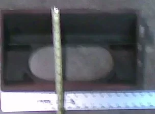

Do yourself a fovor, cut out a small section of the that damper frame. Your liner will be 6"ID , even if you get it through, you won't have any room to work.
webby3650 said:
Litespeed said:
mellow said:
Plenty of people run EPA stoves at 15' and they run fine, it is when you get below that you will for sure see draft issues.
Now a Pre-EPA stove that is designed for an 8" flue, that is the question, will it run on a 15' 6" liner? I would insulate the 6" liner to help with draft, but it might just be time to get a new insert. Sell that buck on CL for $300 and recoup some of your costs.
I think that is the route i'm forced to take, if this "pro" will work with me now that I have a 10 in flue rather than 8in.
I pulled insert out yesterday (weather is quite warm), there is creosote all over the new liner (surprise surprise). Creosote everywhere above fireplace damper.
I'm going to ask him to line and insulate this with 6in and rework the bottom ring connection and top cap for backdraft (no more pour insulation). I measured the fireplace damper, it is right at 6 in, so should get through with a little massaging....
I can work the connection to a stove and insulate the smoke chamber. Still shaking my head.
I'll pay the original quote if he can come up with this (and given i'm sure he gets parts wholesale, should be coming out a little ahead, but not much). I'll even pay for him to sweep the chimney, but I want a thorough cleaning.
If he cannot work with finding some insulation and 6 in liner laying around, then, unfortunately, I will have no option than refuse payment. I will not pay for what I have as it is simply too dangerous to operate, and I would love to hear the excuse for not connecting once modifying the original flue, particularly when the insert has been installed the entire time. This gentlemen obviously does not work by the guidelines established by NFPA.
I'll know more Wednesday.
X2
I bought a small section of aluminum flex at Home Depot to use as a mock up of the liner to gauge how much of the damper I needed to cut out, and went few couple inches larger. Was cheap and very handy.

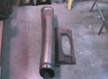

Litespeed,
I think I have just what you need to connect the Buck stove to a 6" liner.
I had this castiron rectangle boot connected to my Buck stove. The boot will transition the rectangle to a 6" dia. ss liner.
If you are interested, it's free for the taking. Let me know!!

Hillbilly said:
Litespeed,
That is interesting.
Looks like an oval though. Did you use the ovalized flex?
Thanks,
Can you verify that is an ovalized adapter, not straight 6 inch round, or some type of photo parallax?
But that certainly seems like a better option than what I have.

BTW, my stove is a 27000 Buck, so it is a 3.5 x 14 inch damper. Verified yesterday when I pulled her out to observe the fireplace.
Is this for a 27000?

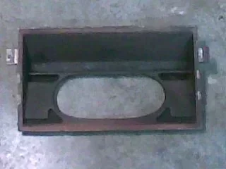

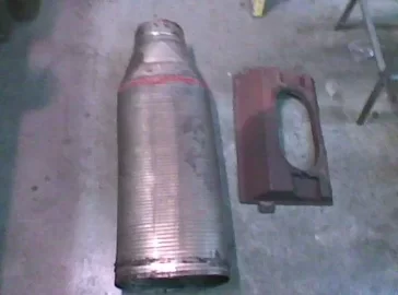

Lite, he has an oval to round section of pipe so the 6" round liner can mate to the oval stove connector.
This is an ovalized adapter that transition's to a 6" round. The ovalized part will fit through most fireplace dampers.
More pics. Sorry for the quality of the pics, all I have is a cell phone camera. The oval to round is 30" in length. The castiron boot is 8" X 16" inside. You would need a short piece of 6" round to go from the 6' round end of adapter into the 10". Stuff some insulation around the 6" were it goes into the 10" to seal it off. Note: I would only commend this type of seal for a temporary setup.

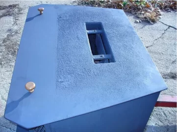

Why would a stove manufacturer make that type of outlet?
Man it sounds crazy to just let the smoke billow out into the fireplace... but then I guess it's not much different than just an open fireplace?
May sound crazy but every one does it. There is a trim kit that seperates the home from the fireplace. The heat carries the smoke up the chimney like you said , just like a fire. Once its hot the smoke will rise.
