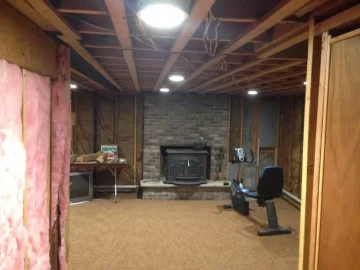

I just purchased an Jotul Oslo for my fireplace. I was running a rear exit old Vermont Castings Defiant but unfortunately the base cracked when I moved it. I have a similar opening - 28 1/2" tall with a 17" hearth extension. The F500 is 26 1/2" tall rear exit with the short leg kit, so it should fit fine. I will know for sure tomorrow and could take a picture as well if it would help. This picture is with the Defiant
  • [Hearth.com] Chimney liner - vertical or horizontal
You would be right around your budget if you went with the Matte Black finish on the Oslo, but mine was $3,000 out the door with the Blue Black enamel and short leg kit.
