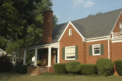

I've changed my mind again... A friend of mine climbed up my chimney today and took the inside measurements at the top of the flue. Interestingly, the top measurements seem to be smaller than the measurements at the bottom of the flue. The inside at the top measures 6.5" x 10 13/16". Since the 6.5" runs side-to-side, I don't see how the 7 3/4" wide DuraLiner will work. I'm going to go ahead and order the 25' ForeverFlex kit and drop that thing down the chimney. (Actually, my cousin, who fears heights much less than I, said he will push the liner down the flue and install the top plate, cap, etc.) Clearly, the insulation wrap will not fit, so I'm going to install the liner without insulation and see how things go. I may, at a later date, go with the Thermix, or I may even stuff some kaowool down into the voids. We'll see what kind of buildup I get. We're going to ovalize the the last couple/few feet of the liner to get it through the damper, then round it again.
One question: From where should I order kaowool? I want to use this to insulate the blockoff plate, as well as for the mantel shield I'm going to have fabricated.
I have included a photo of the chimney. I'm still very open to input and thank everyone for their great advice!

That chimney is gonna be fine without insulation. Just burn that stove right and don't worry about it. As easy a place as any to get ceramic fiber blanket is to search for it on eBay or buy it online from Grainger. You have to be a business to buy from them but just make one up. They don't care, you just pay with a credit card and they deliver in a flash.
This side of the Blue Ridge the weather is pretty much the same at your place or mine and my stoves draw fine and don't crap up the chimneys with flex liners and no insulation on exterior brick chimneys.
I think BeGreen was scared by an exterior chimney when he was little. :lol:
PS: Nice house.
