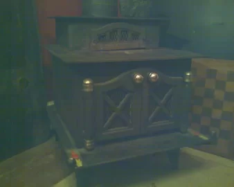

I was given a wood/coal stove made by The Defiance Company. Its in great condition and has 2 ‘draft’ (?) controls. One on the left bottom and one on the right bottom of the stove. There is an 8” collar on top of the stove. The stove has an inspection plaque on the back stating the clearances of 24” side and 24” back. Its dated from 1980.

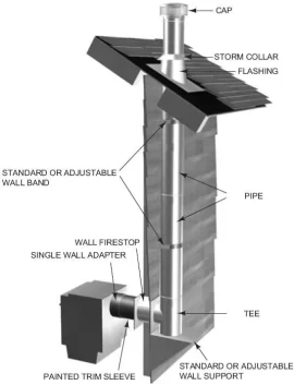

Your install should look similar to this (see pic). You can extend it farther from the house, but IMHO it would look better closer. 3' from window is fine. You will need to run 8" Class A pipe outside. You can run double or single wall black pipe inside (cheaper).
