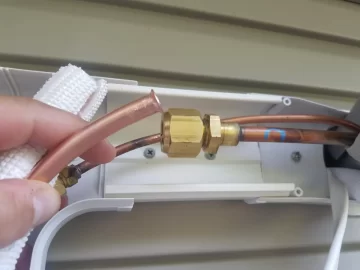

Had the AC tech over last night to get things rolling and we ran into a bit of a problem.
I am attaching 3 line sets to 3 units. A 12k, 15k and 15k. All of them have 3/8" gas line coming out the back and a 1/4" liquid line. Here is the issue..the 15k's all have a 3/8" line with a 1" flare nut for 1/2" line instead of a 3/4" flare nut for 3/8" line. So, everything was going well till we realized that my 3/8" line sets would not work for the 15k units.
We looked in the manual and it seems (vaguely) that 1/2" linesets are required for 15k units. The weird part is that on the back of the condenser unit there is only one place for a 1/2" gas line return. Meaning that on at least one of the linesets, you would need to go from the head 3/8" to 1/2" and back to an adapter that gets you to 3/8" again. All of the returns but 1 are 3/8".
This isn't making sense to us, so we are calling Mitsubishi Monday when the tech line is open.
I only see 2 possible outcomes.
1) I need 1/2" line for both of the 15k units.
For the 1 line I will need an adapter to neck down to 3/8".
2) They say go for it and use the 3/8" (likely with some performance consideration) and I will need an adapter like this to go from 1" flare nut on a 3/8" line to a 3/8" line.

If someone can explain the logic of starting at the head unit with 3/8 line, then immediately going to 1/2 for the line set length, then back to 3/8 at the condenser, I'm curious.

This is the correct mating flare connection coming out of the 12k. 3/8 mating to 3/8 No problems here.
[Hearth.com] Choosing the right brand for a mini-split
15k head unit with 3/8 line coming out of it but 1" flare nut for 1/2" line. That's the issue.

Called Mitsubishi. Unfortunately I will need to replace 2 of the 3/8" lines with 1/2" lines. It is what it is. I will also need the adapter I posted a picture of. There is a local HVAC supply that has their version of that fitting for $5 instead of the Mitsubishi $49 + shipping. Love it.

I have the right adapter in house from a local shop. I installed the Mitsubishi required 1/2" return lines and just got a quote ($~600) for a certified installer to come and finish the job properly. Complete ferrule connections. Full 24hr pressure test. Nitrogen purge and charge.
