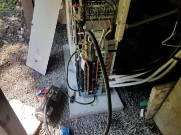

I have a friend that is an electrician and he will be coming to home depot with me to buy everything I need to install 2 20A fuses, run the cable inside, run outside to my disconnect, wire the disconnect and then to the unit.

I went through this with the Mitsubishi tech. Here is the explanation he gave me.I have a question about this. Why did you match the outdoor unit with the indoor unit total btu? I was always under the impression that you could take the indoor units total to 150% of the outdoor.

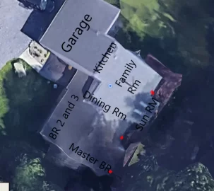

I may have missed it but what size is your house and where are the head units at?

My house is also 1900 sqft but short ceilings just under or at 8’. This has caused me some headaches on what and how to place the heads and where. Not sure I or my wife would like to see the head units almost at eye level but dealing with duct work for the ducted versions doesn’t seem to appealing either as far as matching size of duct work to what the static pressure of the blower is and what not.
Decisions decisions.
