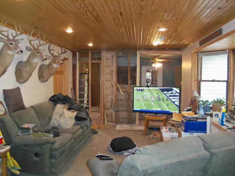

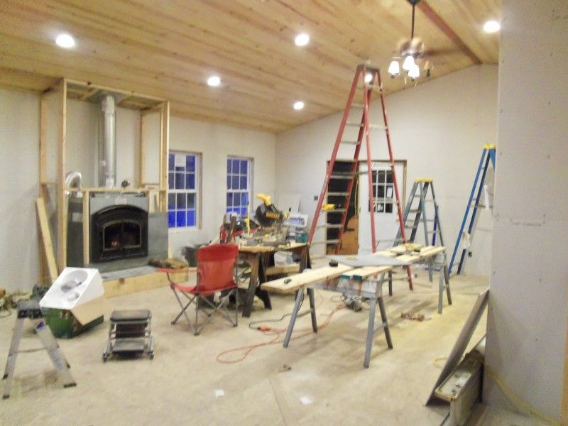

Not sure if this helps but here is a pic of the addition before I finished it.You can see at the far end there is a door. Thats into the old part of the house. New addition has two ceiling fans with vaulted ceiling that run 9' up to 12'. The old part of house has 8' ceilings. The other pic is looking in from the old part to the new addition. I read some place to blow the fan into the heated room instead of from the heated room?

Man you got some pipes running to that stove!

Small door ways can be a hindrance to air flow but yes try blowing air into the room with the stove at a low level.

Yea,It came with two zone heat kits. I ran one to the new basement with also a return air from basement. I can get return air from basement or push lever to left and just draw it from the same room.I just couldnt figure a way to run a zone kit to the old part of the house.

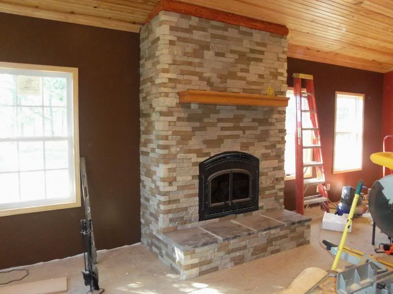

Hope you don't mind me posting pics for you but I really like the finished look and I'm sure some of the guys would like to see it.
[Hearth.com] circulating heat question
Dont mind at all. I have allot of work in my fireplace. And money but I am really glad I did it. It is nothing for it to keep my 750+ sqft new family room at 70 to 75 deg when its 10 outside.I really like it. Propane is up to $399 a gallon here now so I am trying to push some heat to the old part of the house. I have had a fan blowing on low into the heated room close to floor level for about an hour and I think it is helping. I would have never guessed to blow into the heated room instead of out from the heated room.

It can setup a more efficient loop by getting the colder air into the stove room to be heated.
Is that a double door going into the old part..kinda hard to tell from the pic.
Right now its just a 36" door but will be a 6' opening this spring when I finish everything up.Still have the heat and air to get installed and flooring and a back 12'x30' deck.
