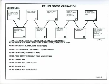

Re-cleaned stove. Put a few pellets in firepot. Pushed reset button. Fan came on, pellets in pot ignited but no auger feeding more to sustain it. Went through troubleshooting guide. Had "professional"cleaner out to"inspect" my cleaning. He said it was fine but thought our auger motor was burnt out. He was willing to order me one for $256. Ordered motor online for $174. Installed it. Still no feeding of pellets.
Called "local" dealer who had to call Quadrafire support. Tried jumping the vacuum switch wires. After more phone calls between the dealer to techsupport and back to us, the consensus was that we needed a new control box. Dealer happy to order it for me and sell it to me for $246 +tax. Found it online for under $200. Ordered it and talked to customer support from the company I ordered it from. They suggested to jump snap disc #2 simultaneously as the vac switch to make sure. Attempted. Now NOTHING, no fan, no little red light, no reassuring click/pause in fan from pushing reset button. Double checked fuse-looks fine.
New control box arrives yesterday; Hooked up, still nothing. Went to dealer's store today conveniently located 45 miles away, purchased snap discs #1 and #2 and some more fuses just in case. Hooked up new SD #2 and new fuse, plugged in stove, still NOTHING. Went through the less than helpful troubleshooting guide again. Attempted to reset SD # 3 by auger motor. Little button will not push in. First time I've attempted this by the way, Still NOTHING when I plug in stove. YES, the outlet is fine. Going to call local dealer in am again-just hoping someone reading here is quicker and more cost effective than they seem to be.

Nephew out here today. Thermostat is the problem, also SD#1 is bad, both the original and the "new" backup I purchased just in case from the local dealer. Current thermostat is a "heat & glo" smart stat II. Did some price checking online today-painful. Do I need to replace with the same product or can I get by with something more economical?? Between the parts, the "cleaners" bill and the nephew's bill - we've almost purchased half of a new stove! Thanks for all your suggestions and help.
You should be able to run with just a normal thermostat. If you said the new disc is bad too, I would make sure the wire ends are good. You should be able to jump the screws where the tstat hooks to on the stove to run it, and jump snap disc#1 wires to get fan to go if you need heat. kap
