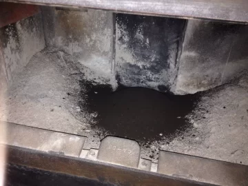

Cleaned the chimney last weekend
Rebelduckman
Dec 14, 2013
1,105
Pulaski, Mississippi
I was happy. Got a cup or two of powder. Cap was pretty clean. Should be even better this year I hope

Powder is good. :)
Reactions: Rebelduckman
Now that's a man who knows how to run his stove!
