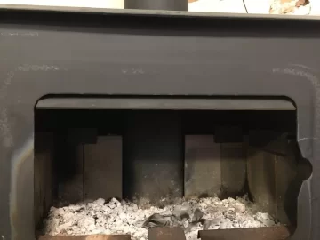

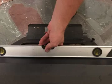

Side note here, before getting to deep with that particular stove, please test the door gasket using the dollar bill method, the last few batches of this stove have been bad from the factory, the stove is stamped cut and I suspect the die used was worn out or bad causing the front steel around the door to have an inward bow, the door simply doesnt seal well and can cause run away fires. the solution from the factory was to increase the door gasket size, which is hardly the fix. test the door seal, then take a straight edge ruler and place against the door opening and see if the stove is bowed.
Wow. Funny you say that. This stove has a warp on top and bottom about 1/16 - 1/8 inch. You can also see when you pop the door off where the gasket was sealing and where it was not. I have been having issues with the fire too so I wouldn’t be surprised if this has to do with it.
