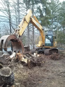

I had a friends remove 20 huge pine stumps from our yard after Sandy a couple of yrs ago. The stumps became a problem because in our town you can't put them in a burn pile. I had to rent a 40 yrd dumpster at $700 to get rid of them. The excavator with a claw could pull smaller trees righ out of the ground. Around here its approx $1000 per day for a machine and operator like this.
